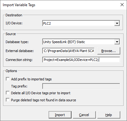

The supported way of importing variables into Citect is through the "import Tags" option in the topology->IODevices form. This gives a few options for Schneider PLCs. The one I am most familiar with is "Unity Speedlink to OFS". I just gave it a test and it worked for me. You will need a running/licensed version of OFS. Downside for me is that it just produces discrete tags for everything. That could be what you want.
There is support for XSY file into Citect SCADA, but it is fairly limited. Only the following driver types are supported:
MODBUS, MODNET, MBPLUS, or UNITE.
Import Variable Tags > Database Type = Unity Speedlink (EDT) Static
The following file formats are supported for this type:
Path of the Unity project file from which you want to import the tags. If the database type is Unity SpeedLink Dynamic, this is a *.stu file. If the database type is Unity SpeedLink Static, this is a *.xsy file.
