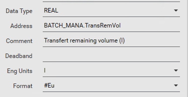

I have a REAL variable with units (here l), and I want to display it with a space as thousands separator, and of course keeping its unit.
The variable have the following parameters :
For example, I have 1245687 comming from the PLC in this variable, and I want to display 1 245 687 l
Until now I haven't found out how to do it... and I have 1245687 l on my display, that is not nice, not easy to read.

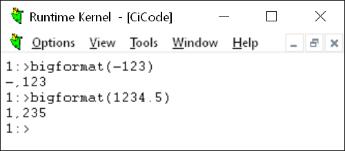

    I don't think I ever tested my code with variables having engineering units in the format (like ##########.### EU). Surprisingly, it seems to work since the function accepts the value as a STRING. When you pass a variable tag with EU in the format, and specify mode 1 (REAL number), it automatically gets converted to a string, like "123.45 RPM". However, if you use INT mode (0), it strips off the engineering units with the decimal places.
    I noticed that BigFormat() doesn't seem to work with negative numbers, and even though you pass a REAL to it, it rounds to the nearest whole number. Of course, if you only need to display accumulators or other large, positive integers, that wouldn't be an issue.

    You're right in your observations. My original function was specifically written for positive integers. My only change here was to accept the real tag from Frederic's screenshot. It also does not return the EU.
