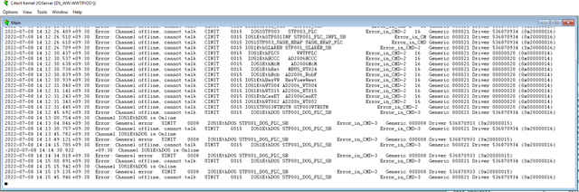

Citect is not communicating with any of the tags in the updated PLC. (Still communicating with all other MODNET and ABCLX devices.)
The error im getting in syslog is: Error: General error UINIT 0008 IOS1EthDOS STP001_DOS_PLC_SB Error_in_CMD-3 Generic 000008 Driver 536870933 (0x20000015)
Is there a way to further narrow this down?
