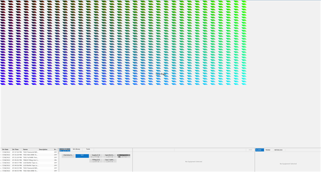

    Not strictly true. I have some "working" code using a piece of text on a graphics page, using DspFont to create a font of the desired colour, and DspText to show some text in that font (setting both foreground and background to the same colour to create a filled box shape)
    However, (a) DspFont (and similar functions) are supposed to be obsolete v3/4 tools and I don't want to hitch my wagon to a solution that won't work in a couple of years, but more importantly (b) DspFont creates a new font handle for each unique font/colour/size combination and is limited to a maximum number of handles (its not documented but experimental evidence suggests 256). Since there's no way to delete (or change the colour of) old handles it makes for a great demo but falls down in actual use.

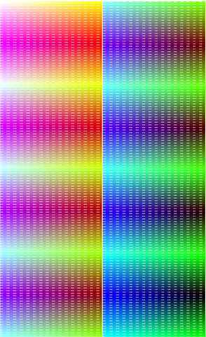

  • Perhaps a compromise?  4096 pre defined BMP's so 4 bits/colour resolution would perform well, and only require a folder to store them in?  The problem would be that it would only really support whatever shape you had them in.  A problem I see overall with this approach is that when you display the page, you need to refresh all of the animations manually with dspbmp.  Also, if someone else is changing the values, you'll need to have something monitoring them and updating the page near real time(?)
    Anyway, 4096 is quite a few colours:
  • But actually there is another set of functions that can can create arbitrary colours at runtime - the Plot functions.  I guess you could say the plot thickens.  You may be limited by the number of handles here as well though.  Could be worth a try none the less.
    I think they already crossed my radar but I can't now remember if I tried them or what happened when I did! I'll take another look.
