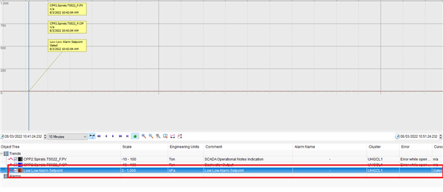

how can change that comment with tag name or equipment name which is appeared on trend name

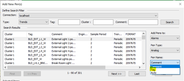

When you a trend pen, the default pen name is the comment of a selected trend. As shown below, select "Tag" as pen name.
thank you for your reply, but the problem is when I add trend from object tree and trend tags appears with comment
and client requires only want to show equipment name if its possible
