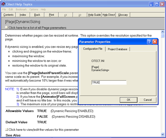

  • If you want to resize the pages in the editor so they look best at a higher resolution, you'd have to do what Nuno said. However, if you're only concerned about making them fit the monitor in the runtime, you can do it with citect.ini parameters. Since there was no Setup Editor in Citect 5.4, you could edit c:\windows\citect.ini in Notepad. Or, go to the Citect help, choose Contents |  Technical Reference | Parameters | Parameter Categories | Page parameters | DynamicSizing. Click the button to edit the parameter and set the value to TRUE
    Use the same method to set [Page] InheritParentScale=TRUE and [Animator] FullScreen=1
    The runtime will now fill the full height of the screen, and popup windows will be stretched the same amount. However, the pages won't fit the full width of the monitor if you have widescreen monitors. There is a [Page]MaintainAspectRatio=0 parameter to fix that, but I don't believe it was available until v6.0.
