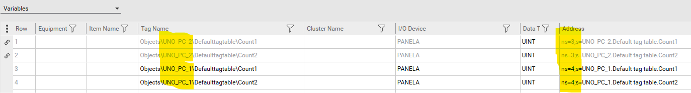

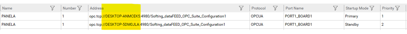

I am looking for the solution in which i want to create the redundancy topology for tow OPC Ua servers. I have two OPC Ua running in two different PC and i created the devices for these two links , tags name are same but due to different OPC Ua PC names they are not working as a redundant system.
so, is it possible to create 1 internal tag and assignee these two different tags to one common internal tag to show the values if one of the OPC Ua is down it start showing the value from the 2nd one
