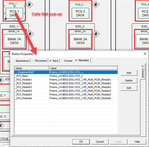

I wondering if its possible to nest super genie popups while adding to the suffix of the association on the second popup call.
I'm calling the first popup using a button using this code...
AssMetadata(-2);
WinNewAt("Pop_FCP_BESS_PCS_DATA", 120,200, 2)
Metadata: [Name: __EquipmentRef, value:Fresno_U4.BESS.ESS1.PCS_1]

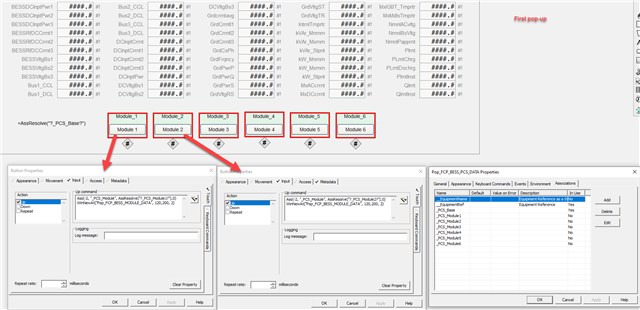

The associations work fine on the first popup, but I need to call a six popups from the first one, but I need to add (concatenate) to the association reference by added a suffix to complete the equipment name for the second popup. I tried the following, but it does not work.
AssChain(-2, WinNumber(), 0)
WinNewAt("Pop_FCP_BESS_MODULE_DATA", 120,200, 2)
Metadata: [Name: __EquipmentRef, value:?__EquipmentRef?.PE_Multi_PCSK_Module1]
The second popup equipment reference should = Fresno_U4.BESS.ESS1.PCS_1.PE_Multi_PCSK_Module1...Fresno_U4.BESS.ESS1.PCS_1.PE_Multi_PCSK_Module6
