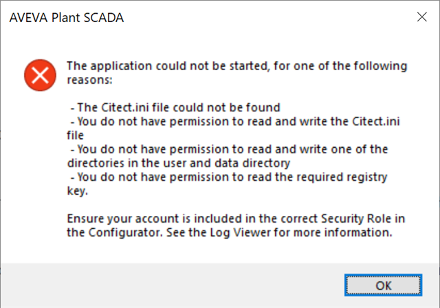

  • It is possible. Check if a Windows user group of Citect.RuntimeUsers or SCADA.RuntimeUsers was created on that machine. If a Windows logon user is not in this group, Citect runtime cannot be launched even for the local administrator. I am sure Plant SCADA 2020R2 (v8.3) and 2023 (v8.4) can restrict users from launching Citect runtime. I am not sure your version. If either of these group doesn't exist, you could create your own group and use this group to apply ACL to citect.ini file (remove all other access users). If citect.ini file is not accessible to a logon user, the citect runtime cannot be launched. Hope this would help.
    The prompt message for the user who is not in RuntimeUsers group.
  • Thanks Jacky, that's a great option.
    Currently they are Running 2016 so we will have to follow the second method until they upgrade later this year.
