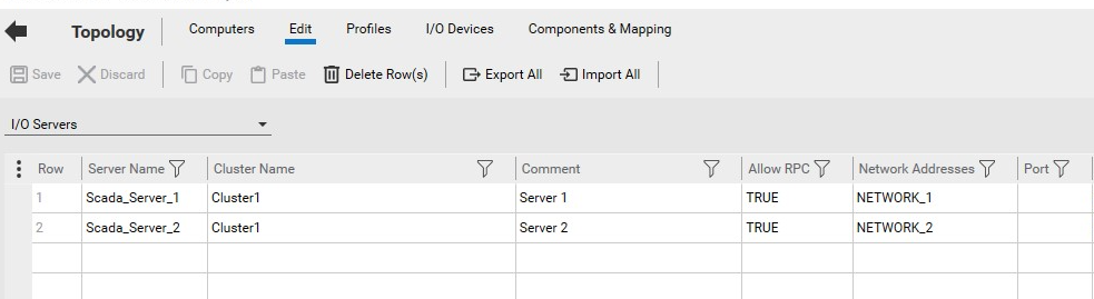

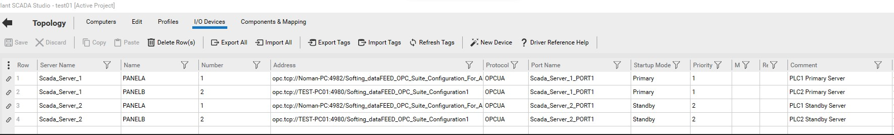

Kindly check the following configurations is it right to do this :
Server 1 could be configured to host the primary IO device of PLC1 and the primary IO device of PLC2.
Server 2 could be configured to host the standby IO device of PLC1 and the standby IO device of PLC2.
Kindly also provide help about boards and ports for both servers

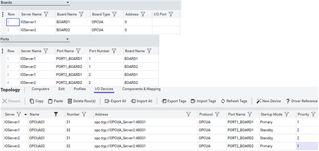

Here is an example of board, port and IO device configurations for OPCUA redundant paths. Hope it would help.

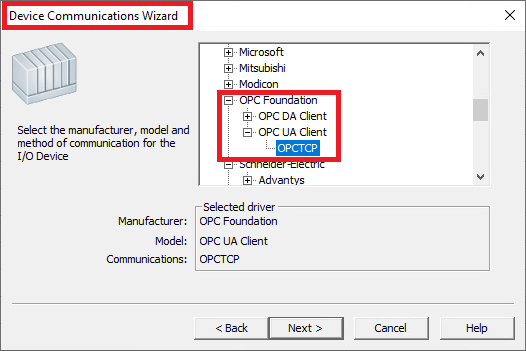

You can also to add your OPCUA devices using Device Communication Wizard as shown below.

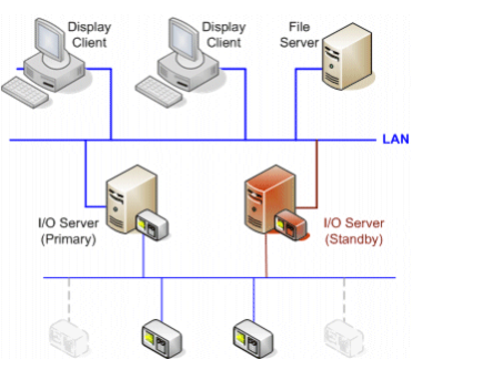

Jack we have this scenario where we have two PLCs (working for different operations ).
communication protocol is OPCUA. we need only IO server Redundancy.
You said there are two servers in your system. In my example, IOServer1 should be hosted by your server machine 1 while IOServer2 is hosted by server machine 2. The diagram you attached is not entirely accurate as IO redundancy is achieved on IO device level. Just treat IO Server (Primary) as IO Server 1 while IO Server (Standby) as IO Server 2 as described in my example..

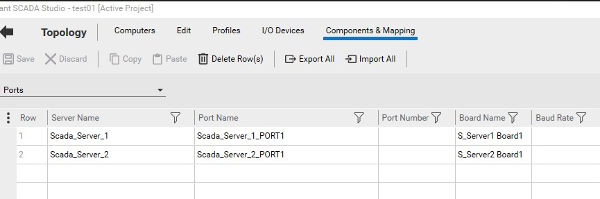

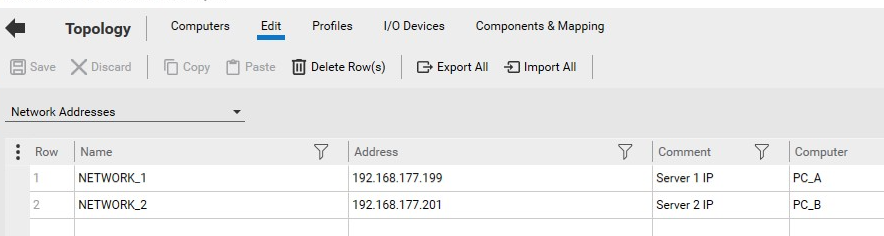

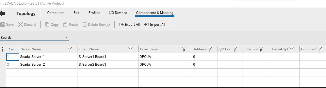

For the IO server Redundancy. kindly check the below attached snaps this configuration will work or not ?
Hi M Noman Danish ,
Yes, it should work. Only difference between yours and mine is that Scada_Server_1 hosts both primary OPCUA IO devices while the standby IO devices are the other machine.

I created Scada_Server_1 host all PLCs as a primary and Scada_Server_2 host all PLCs as a standby
