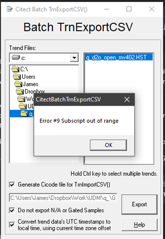

The utility worked great on a smaller set of files (50MB over ~10 files) but when I tried a larger set of data (500Mb over ~100 files) it did not work and I got the error below. Any idea if there is a way around this?

It's possible the trend data is corrupt in some way. You could try viewing it with Trend Reader. It should tell you if there's a problem.
You could also try exporting that trend using Trend Reader or the TrnExportCSV Multi function. If the data files have some corruption, but the data (at least some of it) is still visible in the Citect runtime, TrnExportCSV Multi might be the best option since it exports data by reading it from the trend server in the runtime.
HI Eric, thanks a lot for the reply.
The Trend Reader is actually able to read the individual index files but not the HST file. When I try the HST file in Trend Reader, it provides me with the Error#9 Subscript out of Range window. The Batch TrnExportCSV tool also results in the Error #9 issue.
I have too much data to make going through each individual index file a viable option. Any additional options would be greatly appreciated.
Well, you could use TrnExportCSV Multi from the runtime, as I suggested, since the runtime apparently doesn't have a problem with that particular corruption. You could write a simple function to browse the trend tag list and call the export function for each tag.
Or, you could use my Trend HST Rebuilder utility to create new, valid, HST files, then export them with the Batch tool. The rebuilder can do a folder at a time, so that may save time.

Hi Eric,
Using the tool to rebuild the HST file, I’ve now been able to use the bulk exporter to convert our data to CSVs. Thank you so much for your help.
