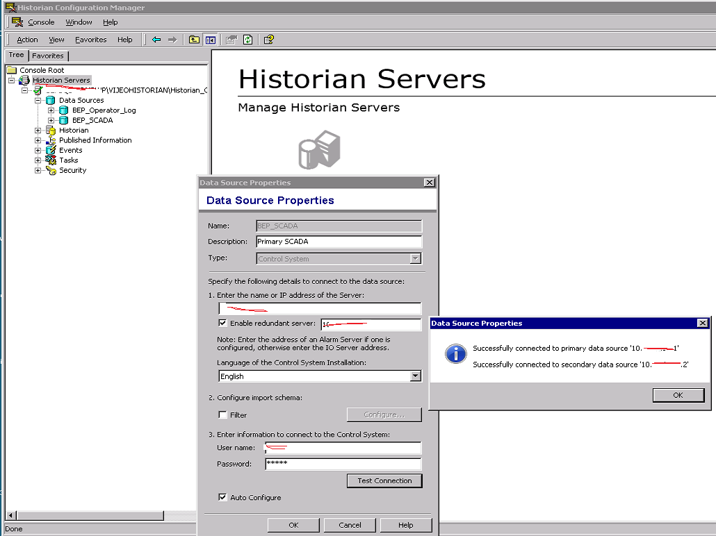

We have changed our primary server to 2018 and get a successful connection notice.

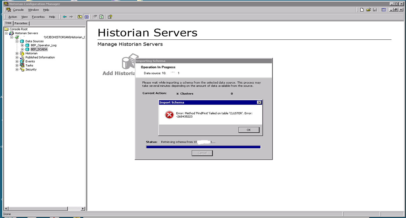

But when we try to import the Schema we get the error on reading Cluster seen below.
the allowlegacyconnection ini parameter is set to 7400
