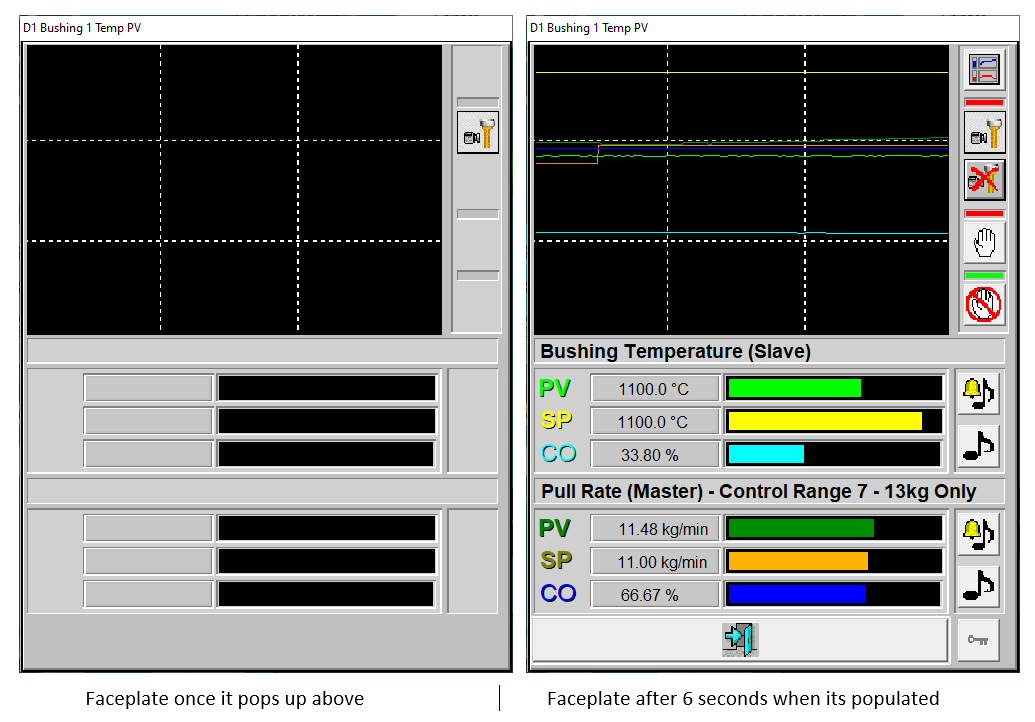

we recently upgrade the serial comms on the DCS to ethernet with a Rovisys OPC90 interface. all is working well except 1 faceplate which has many variables.
this faceplate takes approx 6 seconds to populate all the variables. i have approached Rovisys support and they seem to think its a citect issue.

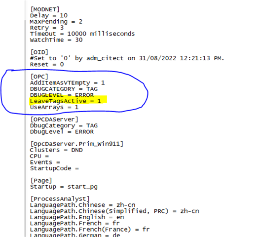

    With OPC, Citect subscribes to all tags when it connects to the server, but the subscriptions are inactive. As you go from page to page, Citect activates all the tags it needs for that page (and deactivates the tags it no longer needs). Some OPC servers are not designed to handle that kind of activity. If that's the problem, you can set Citect to leave all tags active all the time. That puts more load on the OPC server and the DCS, but gives better performance in some cases.
    See the Citect driver help page:
    OPC Driver > Advanced Configuration and Maintenance > Customizing a Project using Citect.ini Parameters > Driver-specific Citect.ini Parameters
    LeaveTagsActive
    0 - Do not leave tags active.
    1 - Leave tags active.
    1
    Determines whether OPC tags remain active even though Plant SCADA is no longer requesting them from the driver. Normally tags are made inactive 5 seconds after the last time they are requested.
    Some OPC servers take a long time to return a call to activate/inactivate tags, or doing so slows them down, therefore leaving tags active can sometimes improve performance.
    The global LeaveTagsActive parameter can be individually overridden by an Active parameter.
    See ItemLifeTime parameter (above).
    Note: This parameter minimizes the likelihood of deactivation of tags on the currently active unit only.  Tags on units that have become inactive (standby) will still deactivate
  • Try what Eric has told you. If it does,t work, try to create a new OPC IODevice equal to existing and change these tags (or half of them) to this new IODevice. It may be work better!
  • Thanks for the reply Eric, i have checked the ini file and can confirm this parameter already existed
  • Thanks Javier, there is 9 faceplates similar so this will require a bit of rework. i will reach out to support on this one i think.

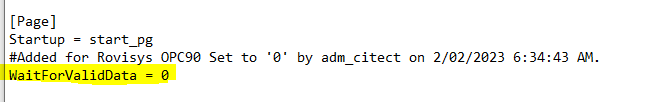

  • Try [OPC]UseOPC2=1 since Rovisys OPC90 supports v1.0, v2 and v2.05 OPC DA interfaces.
    Also consider creating multiple OPC DA IO devices with different scan rates (fast<1s, normal=1s and slow > 1s) to improve the performance. A status tag should be created for IO redundancy.
  • Hi Jacky,
     Do you mean place this in the .ini file as per below ?
    [OPC]
    AddItemAsVTEmpty = 1
    DBUGCATEGORY = TAG
    DBUGLEVEL = ERROR
    LeaveTagsActive = 1
    UseArrays = 1
    UseOPC2=1
  • Correct! This is for global settings. You could also set it in IO device level. For more information, check "OPC Device-specific Parameters" in OPC.chm located in .\Bin directory.
