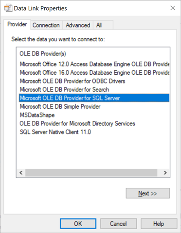

  • It appears to be a problem with SQL access from a remote client. Try to create
    • A text file from Desktop on a remote client machine
    • Rename its extension to udl (you need to deselect "Hide extensions for known file types" from File Explorer Options)
    • Double click on the udl file as shown below (if a desirable SQL provider is available, you will have to download and install SQL drivers pack)
    • Select the same SQL provider as used on the server site.
      • Select the server name
      • Provide the SQL logon detail (recommend to use Windows integrated)
      • Select database
    • Test connection.
    If test connation fails, you need to consider updating the SQL security and SQL connection string.
    You can save the connection details and open the udl file with Notepad where you can find the connection string. This connection string should be the same as used in the project.

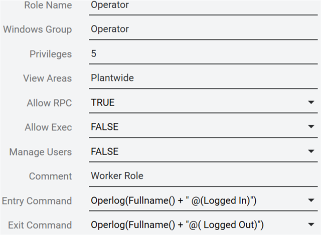

  • Ideally, there should be a central SQL server, which will reduce the load on SQL server maintenance. For logging from each client, it is possible to use Cicode function - ServerInfo("Client", 0) for obtaining the current node name. You could use this information to differentiate similar messages from different clients. I am not sure how the logging trigger is implemented and what messages are logged in SQL server in your project.
    As configured in Example project, the operation log is triggered by Entry and Exit commands, as shown below. As for logging other messages, you have to implement an event to trigger their logging.
