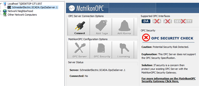

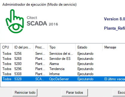

I followed the guidelines shown in this video (https://www.youtube.com/watch?v=4jXubl381dU) but I cannot connect to the OPC Server.
I'm using Citect 8.0 (2016)
Any suggestions?

Hi Iván

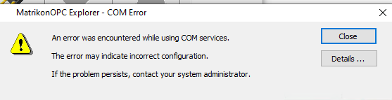

What is the error message if you click on "Details"? In most cases, users experience DCOM authentication error 80070005.
Try to review your COM/DCOM settings in comparison with the ones recommended in the following blog.
If your OPC DA client is remote, you need to also review DCOM Hardening enabled by Windows Updates.
https://support.microsoft.com/en-us/topic/kb5004442-manage-changes-for-windows-dcom-server-security-feature-bypass-cve-2021-26414-f1400b52-c141-43d2-941e-37ed901c769c

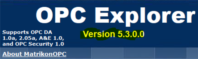

Moreover, you need to upgrade OPC Explorer to v5.3 that supports DCOM Hardening.
