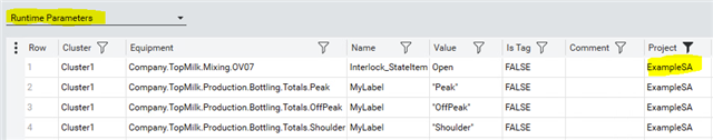

  • "Configuration Parameter" is commonly used for generating alarm, trend and variable tags in equipment model. Cicode function EquipGetParameter, however, is used for accessing runtime parameters. To define those runtime parameters for equipment, please refer to project ExampleSA for how-to. Below is the screenshot of Plant SCADA Studio where you can configure the runtime parameters for equipment in your project.

  • Unfortunately, the runtime parameters are not available in Equipment Editor. Thus, you will have to create those required runtime parameters in Runtime Parameters of Equipment.
