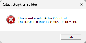

When I try to open the pages in Graphics Builder that contains the ActiveX ,  I get the 2 different error messages:

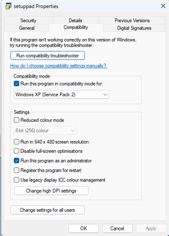

  • You could try to install setuppad.exe.
    http://download.microsoft.com/download/activexcontrolpad/Install/4.0.0.950/WIN98MeXP/EN-US/setuppad.exe
    Set compatility mode to Windows XP and select Run this program as an administartor.

    Interesting exercise this: the setupad.exe installed and played well, opening the old 2003 activex collection just fine, just as my Citect do. However unable to open the newer versions, just as Citect is. It is easy to conclude that there must be missing Microsoft Forms ActiveX support in Citect beyond the 2003 version of the dll, even with lastest update to 2018R2 applied.
    thanks for the input!
  • My conclusion is different: when an external tool like SetupPad has the same issues as Citect regarding the newer ActiveX controls, the issue is probably not in Citect, but in the newer ActiveX controls.
    To be able to use ActiveX controls in Citect they need to have certain properties, like an iDispatch interface. See Tech Note TN000029335 for more details about this. The newer Microsoft Forms Controls probably lack these properties, making them unsuitable for Citect.
    Also, ActiveX technology has been made obsolete by Microsoft. It's no longer formally supported. Therefore, in the future it might become more difficult to get it working. I would suggest making backups of all controls you are using, for future reference.
