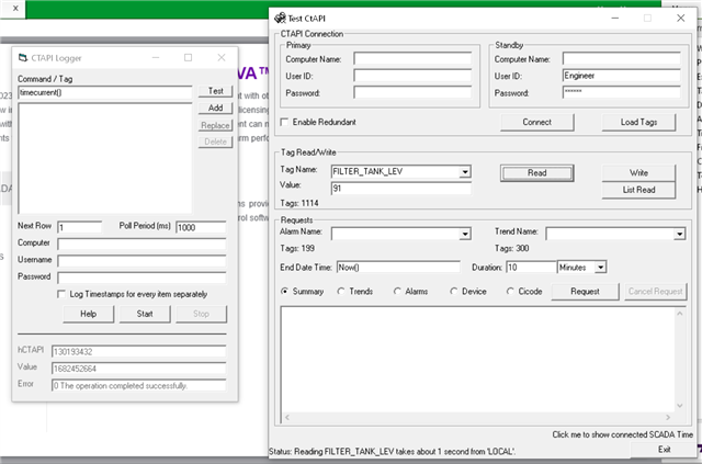

    There are some CTAPI tools and sample code in the Plant SCADA Toolbox under the Tag: CTAPI
    Note that some of these are quite old. However, I tested Citect Data Logger (CTAPI Logger) and Test CtAPI and they both appear to work with PlantSCADA 2023. To make it simple, I just put the EXE files in the PlantSCADA\Bin folder so I didn't need to worry about the DLL requirements.

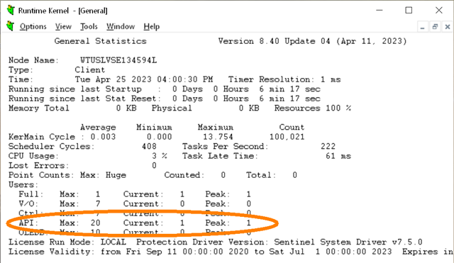

    You also need a CTAPI license (AKA API licenses or Connectivity/OPC Server licenses) for each connection. You normally get CTAPI licenses with a full license. You can view licenses in the Studio | Licensing and in the Kernel | General window in the runtime.
