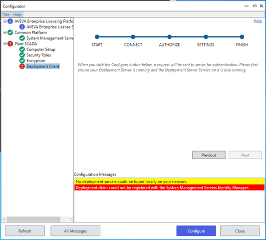

I have been trying to configure a deployment server and client in Plant SCADA 2023 this week.
I have got to the point of the client connected to the system management service but continually get the following message every time I try to configure the client:
"Deployment client could not be registered with the System Management Servers Identity Manager.
Does anyone have some pointers on how to resolve this? I would expect that if the client can successfully connect to the System Management Server then it should not be a connection issue between the two machines.

  • In that case, you should use the same local account to configure the deployment client. The same local account should be created on all nodes with the same password. This is because the deployment configuration is using the current user context (Windows logon user) for authentication. Try to log on the client node with the same account you use to configure the servers.
  • Just to bring this up to date.
    The issue was resolved by installing Plant SCADA 2023 Update 08. It appears that it was a bug that has been fixed in the latest update.
    Thank again for your help.
