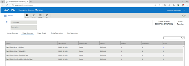

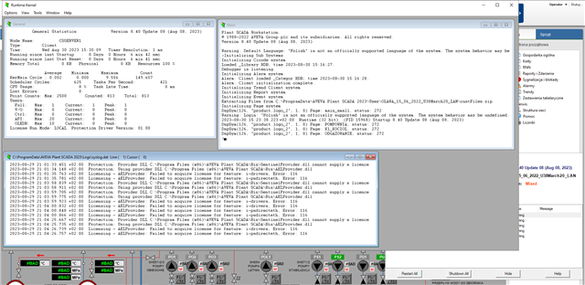

Client won't start, There is error "Software protection error", No licensed control client available or view available on other computer.
In Kernel Plant SCADA license should be visible the number of licenses added by Aveva Enterprise Licence Manager ?
Computers are in the same local network and working group, they have ping. The first is installed Windows Server 2022 Standard, and Windows 10/11 for control/view clients.

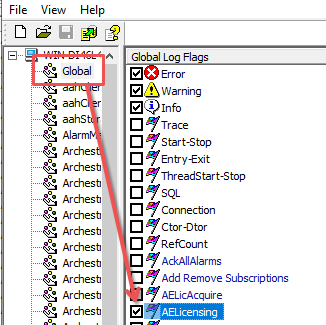

    For licensing logs, there is a separate logger. Open File Explorer and navigate to C:\Program Files (x86)\Common Files\ArchestrA. Open the aaLogViewer.exe. Here you should see some logs. In addition you can turn some log flags on. Go to Action > Log Flags. Under Global you can check the following: AELicensing AELicAcquire AELicTiming Info-Licensing Licensing LicensingDetailed LicensingConnection LicensingBackend
    You can export by going to Action > Export to file.

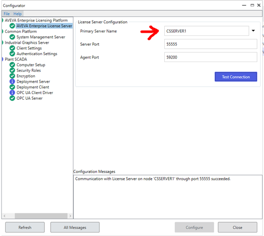

    Thanks for the answer. Logger really help.
    On client side i have to change manually in Configurator: Primary Server Name, then client see the licences from AEL.
    Then Kernel on client start show V/O
    or after change to control also Control

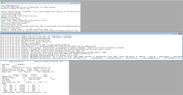

  • Please also provide the aaLogViewer.exe logs as mentioned in my initial reply.

  • I did have a look at the logs btw, as you were kind enough to upload them.
    It seems to me that the client is calling the license server for the licenses, but then you get an system trace for a communication object in faulted state.
