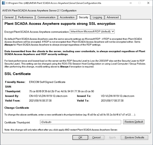

  • Updating SSL certificate is straightforward. Launch Plant SCADA Access Anywhere from Start Menu and go to Security Tab as shown below. Simply place the thumbprint of your own certificate and then click on Apply button. You need to restart the service from General tab.
  • Looks straightforward ok
    So we can use SSL own certificate generated by for example from Windows Server 2022 by local policy or use SSL Let's encrypt to using it  in local network ?
    How about adding cert. from clients scada computers side to not see information in browser unsecure ?,
    That's what I miss in this manual
