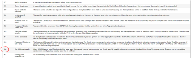

I have a cyclic error report from site on my Plant Scada Server and it causes it to shut down, it started after an upgrade. Any idea what could be causing this? I am going to site next week to check, I'll like pointers. thanks
