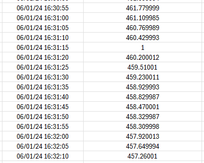

I have encountered a strange problem with trend exporting that I'm hoping someone might have advice for.  It appears to be related to one particular I/O device, which happens to provide  REAL data via Modnet (all other devices on site give INT/DINT data, also via Modnet).  Periodic trending samples the device at 5 second intervals.
Every month we run a TrnExportCSV that is set up to export 15-minute averages (condense method = 0 = mean) for the past month.  A lot of these exported averages are coming back as "n/a", and it appears to be because among the valid logged floating point data is the occasional value of "1" (without the quotation marks).  Any 15-minute period containing a "1" results in an "n/a" in the .csv file (so there can be 179 valid numbers, and a single "1", and that is enough to break the averaging).
I tried including Mode = 4 (Ignore any invalid or gated values) in the TrnExportCSV parameters, but all that did was produce a blank cell instead of an "n/a" cell in the csv file.  It doesn't just omit the invalid value and calculate the average using only the valid numbers as I was hoping it would.
Any ideas how this can be overcome?  (and why these occasional strange values of "1" might be appearing in the first place?)
(Unfortunately, 1.00 is a valid value for all of the tags affected, so excluding values of 1 is not an option)

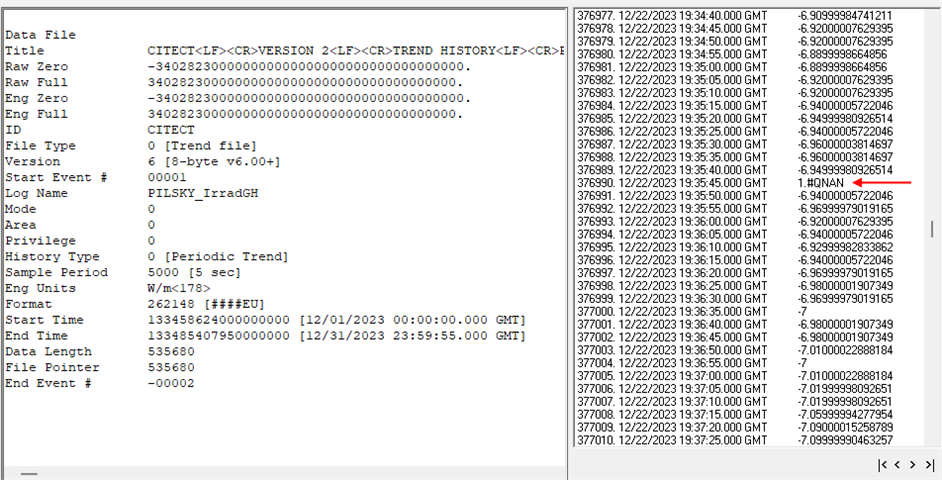

    You could also try using TrendReader to view the trend data files. I'm curious if the '1' values are actually 'N/A' (invalid) or 'Gated'

    Thanks to your Trend Reader tool I can see the problem - a data sample logged as 1.#QNAN
    I'm not sure if this points to a problem in Citect or in the IO Device.  I wonder if it could be possible to mask this issue by incorporating an expression into the trend tag definition rather than just logging the variable tag.

  • 1.#QNAN indicates the value is not a valid floating point number (Quiet Not A Number). The PLC may be creating that intentionally because of a math error (such as divide by zero) or a sensor failure. There are millions of possible combinations of bits that result in a NAN floating point value. Citect does use 2 of them to indicate a trend sample is N/A or GATED. I don't believe Citect checks for any other NAN values.
    Since doing mathematical calculations on NAN values is supposed to cause the result to be NAN, I think that is causing the trend server's Min/Max/Average calculations to fail. Since TrnExportCSV() and my TrnExportCSVMulti() both call TrnGetTable() to get the calculated samples from the trend server, this problem would probably affect both functions. You could use either export function with the sample rate that the trend records at, like 1 second. Then, you'd have to eliminate the bad sample and do the averaging yourself.
    I think the real solution is to avoid recording the bad value. If you can check for the bad value in the PLC, you could set the register Citect reads to the last good value. Or, as you suggested, use a Cicode function in the trend expression to change the QNAN value to Citect's N/A (not available). For example:
