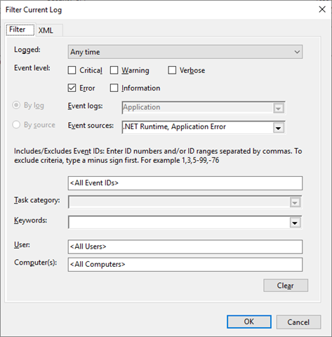

    Connectivity Server is a standard Windows service running under a virtual service account. It should be in the run mode automatically once installed regardless a SCADA project is running or not. Have you checked Windows Event Viewer when Connectivity Service starts up? There could be an exception that prevents Connectivity Service from running properly. You could use the filter with .NET Runtime and Application Error in the event log (as shown below). Hopefully, you could find some useful information.
    I am not aware that Citect.Connectivity.Server.exe is trying to raise the SELoadDriverPrivilig. If the problem still persists, you should reach out to Technical Support for further troubleshooting.

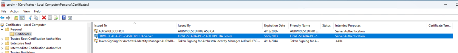

  • Certificates are managed by PCS. I don't think PCS likes it when the machine name is changed.
    I'd recommend uninstalling PCS (then check registry to make sure any reference to PCS and the old machine name is deleted), the install PCS again. This should clear up the issue you were facing.
  • Hi Olivier,
    I have uninstalled PCS however when I look in the certlm.msc there is still a certificate there as below. It
    It looks like that certificate has been there potentially since the packages were first installed last year by others. Uninstalling PCS has made no difference.
    Can I simply delete that certificate before I re-install PCS with the hope a new one will be created?
  • Hi  ,
    As Olivier pointed out, PCS framework currently doesn't support changing the machine name after installed. You can manually delete the old certificate. Reinstalling PCS should install a new certificate of OPC UA (you may need to restart the machine after reinstallation). If the certificate is still not accessible (the message should be reported in Logger Viewer), try the following steps.
