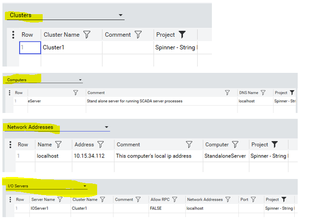

i have created a new test project as i also need to change some cicode and want test this before rolling it out to existing system.

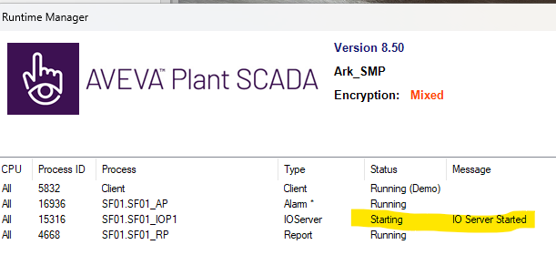

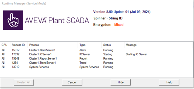

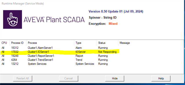

project compiles, no errors or warnings, it runs up and graphic pages load and all looks ok except the IO Server process does not run and i cannot establish comms to my 2 IO devices.
i am sure i have set something up wrong.
Where do i start ?
