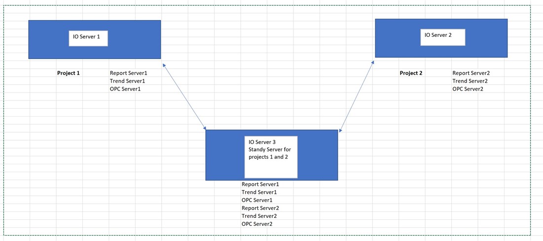

We have two plants with 2 different Citect SCADA R2 projects. One system has a standby server, the other does not have. Is it possible to use one standby server for 2 projects?
Hi Simon Mungwira ,
You would need to test this thoroughly yourself, but I don't see why this would not work. It should be possible.
You will need to run a combined project on the Standby, since it needs to know about the Primary Servers for Project 1 and 2.
This will require unique cluster per project, and also unique tags in the combined project.
Do let us know how your testing goes.
