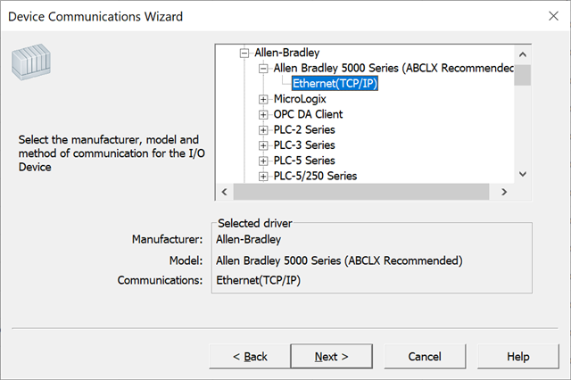

  • Hi
    • You can use I/O device wizard (as shown below) to create an ABCLX I/O device against I/O server.
    • Update the field of "Special Opt" of port with IP address and slot number for each new I/O devices. (please refer to Driver Reference Help for details)
