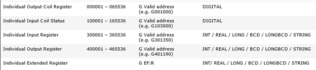

  • Just add the letter G before the tag address to force that variable to be read individually. That slows communications so you don't want to do that for too many variables. You could just do it for the even numbered REALs and LONGs, for example, or just the problem ones.
    Here's a clip from the MODNET help page on Data Types:
  • Thank you so much, it is working after adding the letter G to the address.
