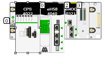

For our new project configurations, we had M580 redundant controllers (H58-4040) with AVEVA plant scada 2023 (citect) with redudant servers.
