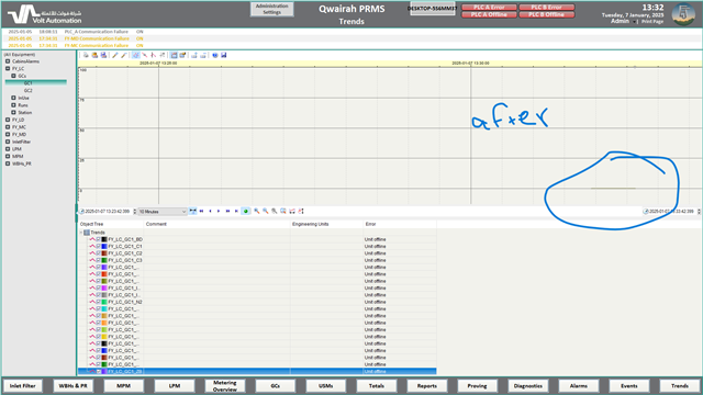

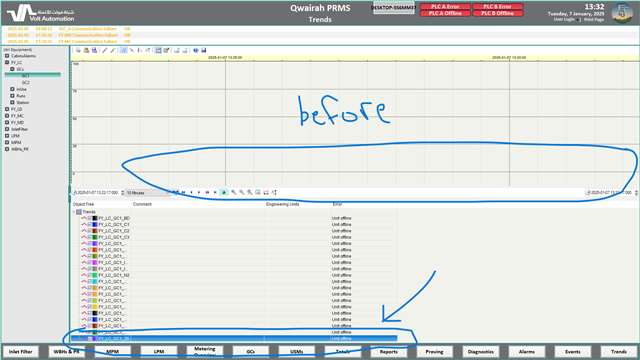

When I open the trend view in runtime, it do not show the trend values unless I press on the trend view or move the view right or left.
I am facing this issue in instant trend view and in full trend view in my runtime and I will attach 2 photos that shows the trend before and after I press on the view.

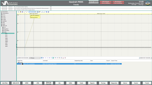

    I believe it is not a data request issue because once I click on the view all the trends in the equipment will show the trend and everything will be normal.
    1- This view is the default view of the process analyst, its working principle is that you select an equipment from the tree on the left side and it adds all configured trends in that equipment type to your pane under the trend view.
    2- this error is because i am not connected to the actual network and there is no real reading, but I am sure it happens also if I am connected to the network that contains those tags values.
    3- the trend server is not busy.
    Note : This is simulation for values to make sure the Unit Error is not the issue.
    and as you see this equipment only have one pen and it behaves the same as if any other equipment is selected.

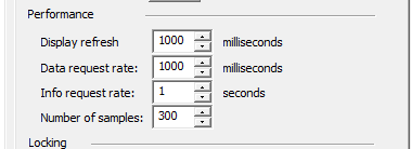

      1. Can you confirm the DisplayRefresh, DataRequest, InfoRequest rates please?

  • 1-
