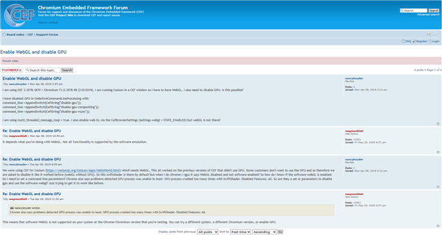

Link to Chromium Embedded Framework Forum where users discussed how to enable WEBGL in CEF.

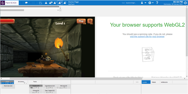

Yes the screenshot I showed you above is using the Web Control we will built for Plant SCADA 2023.
It is currently built on CEF(wrapper around chromium). The demo above was from a clean vanilla Windows 10 vm (hyperv) with PS2023 installed and the ExampleSA project modified to display two websites. There was no need to enable anything. As it can utilise GfX hw, you will probably need to make sure you have a decent gfx card capable of matching the features required by whatever you are rendering. As I said we haven't done WebGL testing (and do not plan to) so I can't give guidance on Gfx cards, etc.
