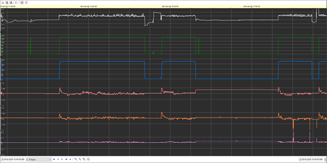

    This is what I am trying to chart:
    6 pens, all in one pane, stacked.
    In this example I added the pens manually but I want this to be set in the up-command line like I did in the normal trending code (see above)

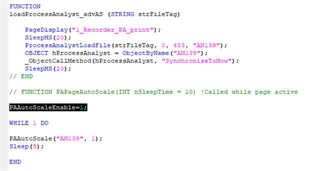

  • Hello Greg,
    I tried to incorporate your code into my code and ended up with this:
    FUNCTION
    loadProcessAnalyst_advAS (STRING strFileTag)
    	PageDisplay("1_Recorder_PA_print");
    	SleepMS(20);
    	ProcessAnalystLoadFile(strFileTag, 0, 483, "AN139");
    	OBJECT hProcessAnalyst = ObjectByName("AN139");
    	_ObjectCallMethod(hProcessAnalyst, "SynchroniseToNow");
    	SleepMS(20);
    // END
    // FUNCTION PAPageAutoScale(INT nSleepTime = 10) !Called while page active
    PAAutoScaleEnable=1;
    WHILE 1 DO
    PAAutoScale("AN139", 1);
    Sleep(5);
    END
    END

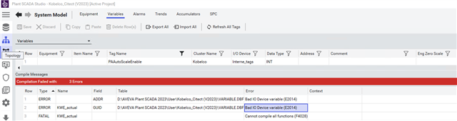

    But during compilation I get:
    referring to:
    Any idea what I am doing wrong?

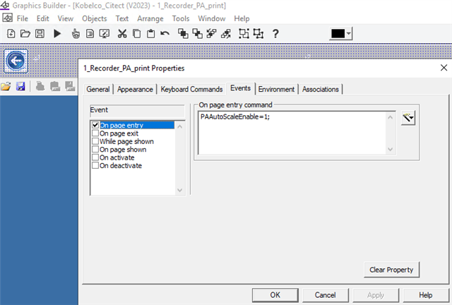

  • PAAutoScaleEnable is likely to be either a local or global variable (or tag) designed to turn autoscaling on or off for their project (e.g. attached to a button or something on the page).
    The function Greg gave you doesn't actually use it, so you can delete it.
  • Hello Bradley,
    After removing PAAutoScaleEnable=1; it compiled correctly but the trend will not autoscale.
    I am missing some command to execute the 2nd function every 5 seconds, I think.
    The intension should be that when this page is visible (loaded/displayed) every 5 seconds the trend Y axis is updated based on the max and min values
