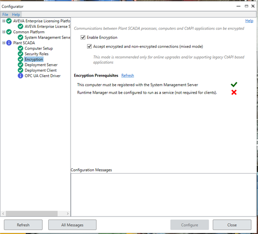

  • Thanks Jacky, i will look into the write issue, can you explain the following please
     Also 2020R2 server should be configured to run in the mixed mode in order to communicate with the 2018 subsystem if PCS SMS is configured
    i can confirm 2020R2 server is in mixed mode (encryption in configurator) what do you mean by PCS SMS ( the  client pc's system management server ?) on 2020R2 server the runtime is not running as service does this matter?
