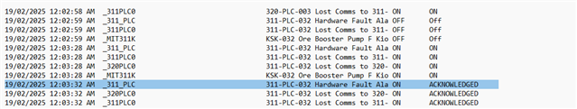

Asking about CITECT.INI, is there any risk that I should know about before changing this and if I do change it, how is the INI file rolled out? Do I have to restart the server that holds the CITECT server? or compiling then run is enough? I wanted to change the INI file for report. For some reason, the ALARM log files that gets generated have tagnames cut into 8 characters only. I know the default should be
"{LocalTimeDate,23} {Tag,32} {Desc,80} {Category,16} {LogState,16} {State,16} {State_Desc,16} {Type,16}"...but for some reason, I think 32 characters is for timedate and tag.
II can definitely see 23 characters for Time and Date, but the tags have only 8 characters in it.

    As for the truncated tag names in Alarm Log files, you need to check the format of the configured log device. The format defined in citect.ini is for display only.
