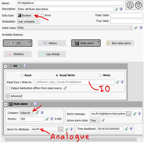

    For the limit alarms, have you tried the associated attribute function? I'd like to hear your take on it. It allows you to create a Boolean, link it to the PLC and then set it as an alarm and link an analogue attribute to it:

    I had a look at the attribute you mentioned. It did not seem to do anything in InTouch or OMI. My understanding is that it works for the historian client, but not for real time alarming. Is that correct? I haven't had a chance to look at this for 2023-R2 though. I will have to look into that.
    It would be a solution if we could connect the boolean alarm to both a analog value and a limit value separately, and if these values were actually integrated into alarm so they were sent to the alarm buffer.
  • No worries.  Yes, that analogue is just used in the historian, although I thing you can get the name of the analog in runtime if you have the alarm itself.  Today the limits will have to be created as separate attributes. There is an item on our backlog to allow users to consume an external alarm and treat it as part of our alarm subsytem, but it has not been prioritised yet.
