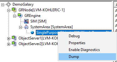

    It is possible to dump an instance data to SMC using Object viewer, double right-klick on the object and then select Dump.
    This will dump a lot of data, not ideal and pretty, but could be used in a scenario where you have no other options.
    You will need to manually enter the values after deploy.
  • Thank you for your comprehensive answer, I will have to look into this further. did not realize about the dump from object viewer! When doing a dump from the object viewer, where would that be stored? Is that a CSV file? I am reluctant to try it until I am sure about what happens...
  • Hi Jakob,
    The information of this dump file is written in the SMC logger.
    I don't think it is transferred to a file. I can't find it.
    So the last screenshot of Richard is from there.
    There you can find the attributes of the object and their value
  • Hi,
    You are correct in that the Dump action writes data to SMC and that's where my screenshot was taken, it will not save anything in file format such as CSV.
    You will need to manually copy the result to ie, excel to 'clean it up' or filter it as per requirements.
    remember that you can apply filters in SMC as well.
