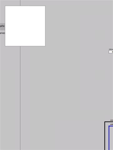

Hi! I frequently end up with a white box appering in the left upper corner when accessing the OMI through Web (accessanywhere.)
Screenshot:
Are there other that have seen this?
regards
Jakob

Hi Jakob,
I believe this is a known issue that has been solved in ITAA2020b.
I don't know which version you use and how you use it.
This white box issue could occur if ITAA connects to a previously disconnected session. If you set the OS to terminate the disconnected RDP sessions and also exit View every time, instead of closing the browser; you can largely prevent this issue from occurring.
