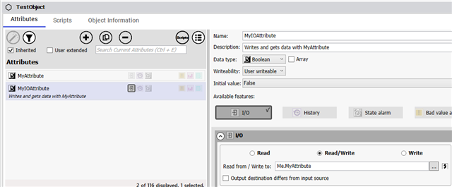

    I've created an object with two attributes. (booleans)
    One boolean has an I/O reference to the other:

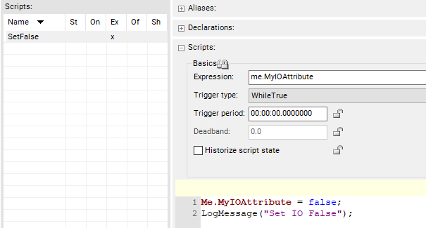

    I have 1 script that set's the IO attribute back to False:

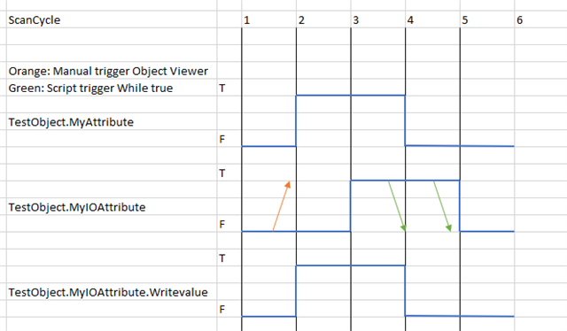

    - I change the MyIOAttribute to True in the objectviewer.  (during scan 1)
    - MyIOAttribute,Writevalue and MyAttribute is set to True in the next scan. (scan 2)
    - MyIOAttribute stays false until scan 3.
    - The script is triggered in scan 3 because MyIOAttribute is True (scan 3)
    - This will run MyIOAttribute = false (scan 3)
    - In Scan 4, the MyIOAttribute is still True and MyAttribute and MyIOAttribute is set to false (scan 4)
    - Because MyIOAttribute is still True, the script is triggered again (scan 4)
    - In the last scan, MyIOAttribute is set to False (scan 5)
    Here a visual representation:
    My conclusion in this is that a change of an attribute with IO is held in the .Writevalue field and written to the IO.
    But the attribute itself is not changed, because it still reads the old value of the IO.
    I don't see any difference in changing the script execution order.
