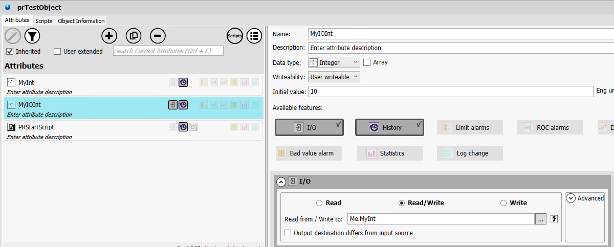

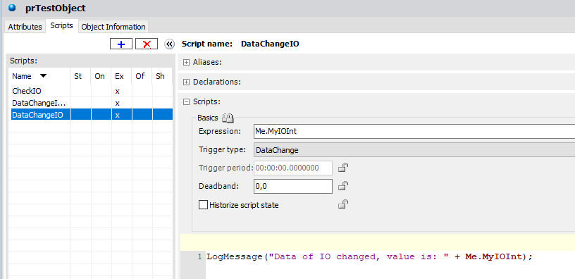

Some screenshots
MyIOInt which points to MyInt
MyInt

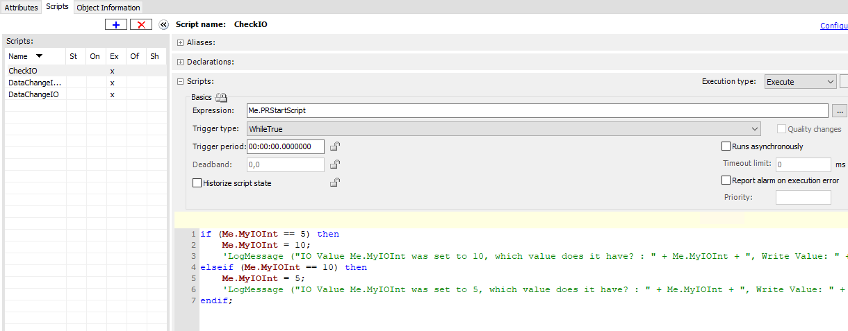

Switch script, triggers while true
DataChangeIO Script

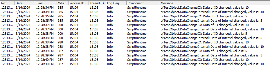

Result in logger to see the timing:

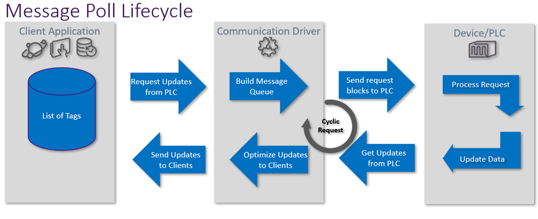

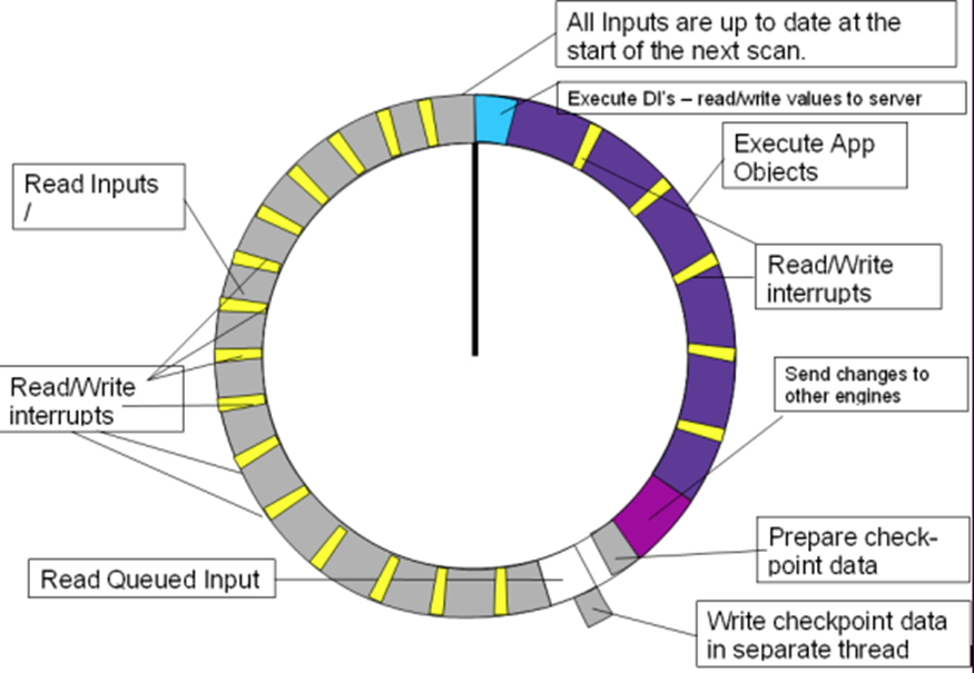

  • It is quite a broad question but please reefer to the following image describing the scancycle
    When working with OI Attributes you also have the Write interrupts that could effect the behavior.
    There are multiple things that effect the path of an IO attribute and especially if your data is coming from a PLC and not the same object.
    Also cross engine communication could also effect how data is managed.
    You could also monitor Me.MyIOInt.WriteValue to verify pending writes.
    Value of Me.MyOIInt (or Me.MyOIInt.Value) is also verified value from source.
    You can not expect a IO attribute to have the value you are writing within the same script cycle.

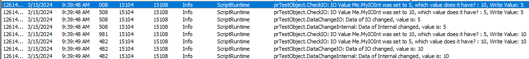

    In my script I also tried to log the write value.
    First cycle:
    1.1 Script executed => Checks if value is 10 => Sets it to 5 (Write value is 5)
    No data change script yet fired because I/O value didn't change
    2.1 Second script execution => Now checks if value is 5 => Sets it to 10 (Write value is still 5)
    2.2 Data change scripts are running and showing the value of 5 (makes sense to me)
    3.1 Third script execution => Now checks again if value is 5 => Sets it again to 10 (Write value now 10)
    4.1 Fourth script execution => Now it checks if value is 10 => Sets it to 5 (but write value is 10)
    Rinse and repeat. Below screenshot with the 4 scan cycles.
  • But still I would like to stress that the suggestion that working with Attributes with a OI extensions requires you to understand that the Scan cycle and how data is traversed down to the source (usually using a device integration object).
    Compared to Attributes without OI extension, then the object that can be expected to change value and use within the same script cycle.
    The example presented is using a different Attribute as source on the same object so it might not be fully applicable to the message poll lifecycle image.
    So a common issue for someone new to this topic is that you set the value and on the next row expect this to be available.
    Me.MyIOInt = 1;
    If Me.MyIOInt == 1 then ...
    The above is not a good practice or has at least up til version 2023 P03 been an issue and has to be understand.
    Me.MyLocalInt = 1;
    If Me.MyLocalInt == 1 then ...
    The above will work since it is not adding the write to the write queue.

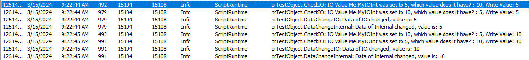

  • Thanks for clarifying, There is also a possibility to change the Execution order of the script, Default is "Just Before outputs", You could change it to "Just after Inputs", would be interesting to see how that effects your test.
    I have to try in 2023 R2 if something has changed based on my legacy experience that effect this, before making any more statements. Slight smile
  • Hi Richard,
    Actually I did the test in 2023 R2 first and then decided to see if it was different in 2020 R2 SP1.
  • Test with "Just after inputs": Looks identical
