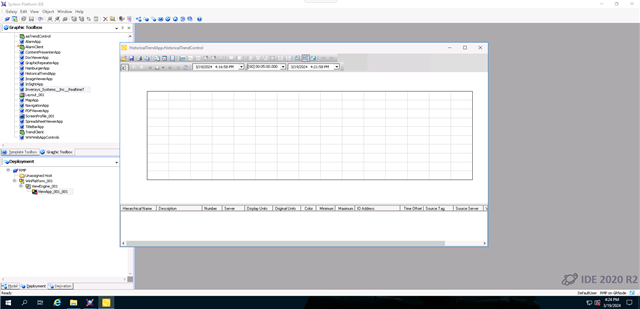

    You might be experiencing issues with using the .NET controls within OMI as in earlier versions of the offer this wasn't a supported feature (2017).. there is a workaround to this as indicated below.
    https://softwaresupportsp.aveva.com/#/knowledgebase/details/000021465?lang=en_us

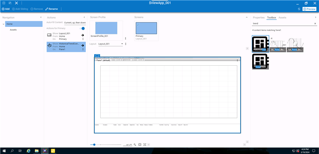

    There should also be a "HistoricalTrendClient" control as part of the Galaxy that can be utilized however the .NET Controls be found at the following directory, if you'd like to experiment with the documented steps above.
    C:\Program Files (x86)\ArchestrA\Framework\Bin\AVEVA_Software__LLC__aaHistClientTrendControl.dll

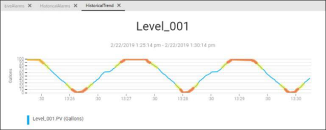

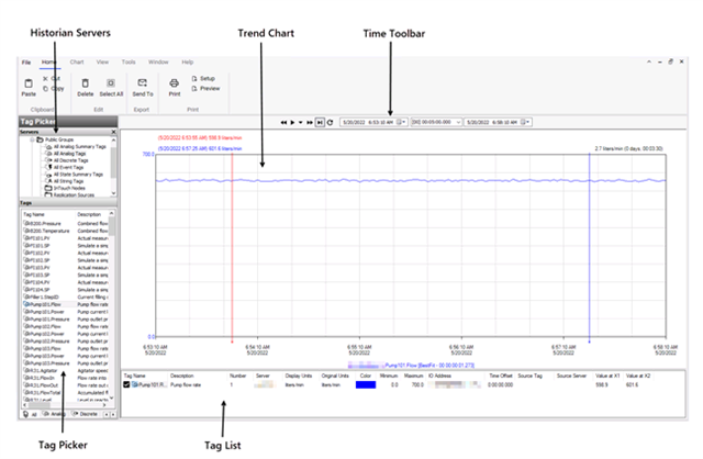

    A quick explanation about the "Historian Trend App" is a standalone app, which contains a set of properties that can be configured in both design and runtime. The design-time properties are set to default values that enable you to show trends in your ViewApps with minimal configuration work. Changes made to a property during run time override the value set to the same property during design time.

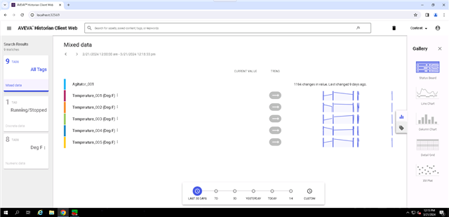

    We also have have another app called InsightApp, which allow users to run an active Insight (Historian Client Web) browser session within a pane of a running ViewApp. The application provides visualization of data by retrieving information from Historian, it includes search functionality in which users can enter keywords into the search to retrieve relevant information.
    Image of InsightApp within OMI
    Image of Historian Web Client on browser

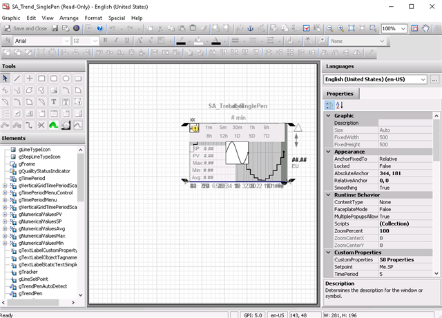

    Another option which I believe you may currently be using (correct me if i'm wrong) is the Situational Awareness symbol trends, that utilize Industrial graphic pen plotting features to display information.

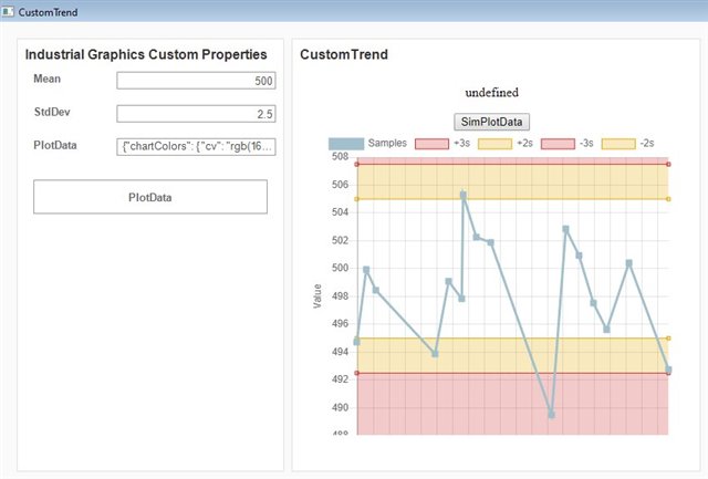

    Alternatively there's another option using the web widget technology in which we can create our own controls to render information. You may have seen these controls already prepackaged as part of the installation but features like carousel, web browser and qr code scanner have been built with this flexible technology.

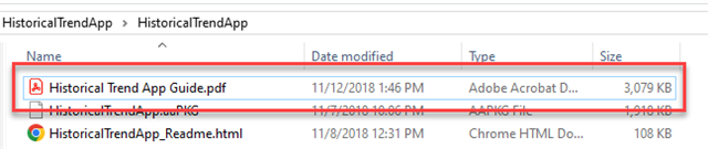

    For more in-depth detail regarding usage of Historian Client Trend App, you can navigate to the following link, you'll be prompted to input your contact details but once you've downloaded the files you'll get 3 files as part of the zip which will include a readme, guide, and sample code (.aapkg import). Importing is not recommended (see readme)
