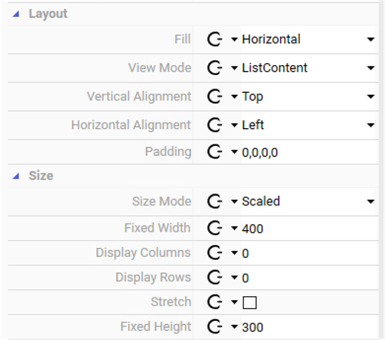

Are there any technical difficulties that prevent Content Presenter app from accepting input references for its configuration, primarily with regard to size properties?
Ideally, one would be able to configure display columns and display rows (and other properties) as input references instead of configuring multiple layouts with different configurations.
  • The simple type of properties can be coded to enable the reference binding to take the dynamic values at runtime. The properties like enum type can't be reference bind with the current version of the product OMI's framework.  You may want to reach out to the product portfolio for this enhancement to the app. Having said that, there is source code made available for this App as part of the SDK, which means you can customize the app to enable the data binding on the properties as per your needs, compile and use it as your own App :-)

  • Let me describe the goal that we are trying to achieve and my thought process.
    There is an area hierarchy, and each area contains some real-time KPI dashboards. These dashboard vary in sizes given the nature of KPIs being presented varies between areas. For showing these KPIs, idea is to use Content Presenter app. It would be linked in each of the areas and configured as to display KPI dashboards from areas direcly below the it.

    Dynamic data binding would be used, for example, to configure number of rows and columns that Content Presenter app would try to optimize for. So, at root level, Content Present app's rows and columns properties would be bound to appropriate set of attributes in the root area (for example, 2 rows and 2 columns given that there are 4 dashboards) etc.
