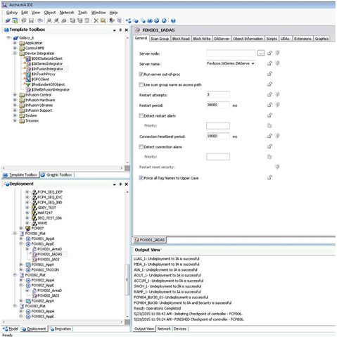

     I am using $InFusionIntegrator Object to Make OPC DA server "IADAS" on system platform, so I am more interested of the OPC server version that is created by this method and if there is a document that, I can refer to.

    Also by the screenshot it's seems to be built on an older version of Application Server, so please specify version info and it might be easier to find what's available for you.
  • As mentioned by Richard, that object is not part of the standard AVEVA System Platform, but is supplied as part of a product from Schneider Electric Process Automation. That product is based on AVEVA System Platform but includes some product-specific objects and extensions including the $InFusionIntegrator object.
