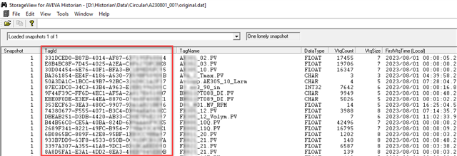

  • The important thing to know is that the Utility will modify the TagId in the existing History blocks, to ensure data availability after consolidation.
    If you remove a TagID from the table manually using a query, then you will loose that that corresponding datablock.
    (Example of Datablock content, TagID is used to provide data to Retrieval service)
    Also you need to have all datablocks in Historian when performing this cosolidation, so if you have backup data (let say data older than xy years) it has to be moved to historian before running the tool.
    Otherwise the tool will not be able to update TagID and the data will not be available if you move it 'back'
