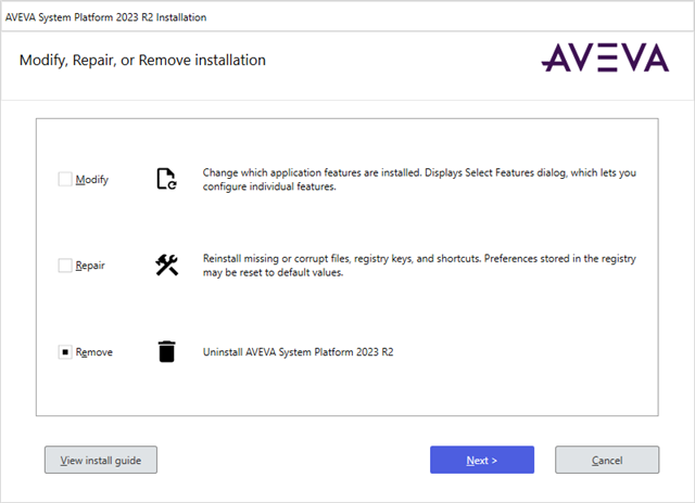

Usually you get very far using the Installation media, and select remove from the setup.
But since you mention that you have issue uninstalling i guess this is not an valid option.
ASP is so many various components and software that can be individually uninstalled through add/remove programs.
But there is a technote available for version 2020, it might give you some guidance
softwaresupportsp.aveva.com/
Forum seems to remove links behind login. I added a space in the link in hopes that it is posted
https:// softwaresupportsp.aveva.com/#/knowledgebase/details/000032573?lang=en_us
