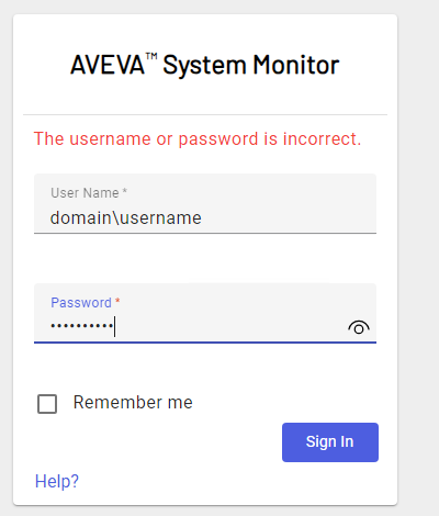

I wanted to try out the System Monitor while I have a test install on hand, but can't figure out how to login into the web page. If I understand correctly, I should be able to log in with the account used during install, but I always get an error "The username or password is incorrect" (both with and without the domain name)
Tried uninstalling and reinstalling with another domain account, same thing.
The service account is the only one that gets a different error , "User not authorized".

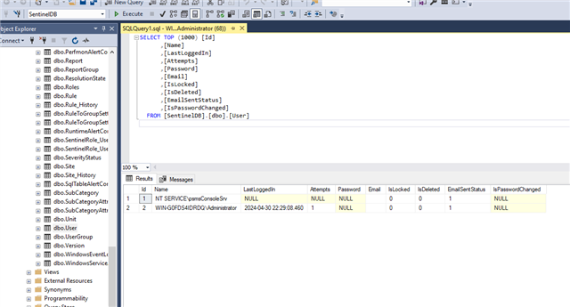

  • What you can do is to review the database SentinelDB and the table User to view what user is created by the install.
    In my case the default user is the local account Administrator, after login I will be able to add more users in the Configuration section in the portal.

  • If you have access to the database you could actually edit the user table, modifying the username to your current and available user. (no password is stored in the database).
    It has to be in the format of domain\username or if it is a local account computername\username.

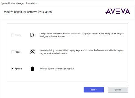

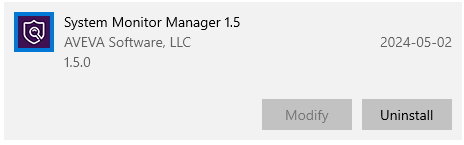

    Edit: As you mentioned, Un-installing System Monitor Manager component from Apps and Features and then installing it again using SP 2023 media, selecting Modify and then adding System Monitor Manager again did not create the database in my test either.

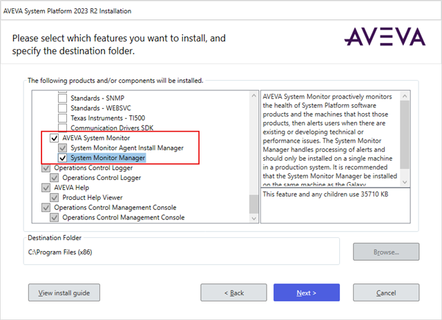

    Then I could remove the Sentinel Monitor Manager using Apps & Features

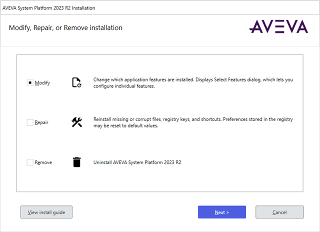

    After this has completed I could add it again by initiating the System Platform 2023 R2 Install, selecting Modify
    Finalizing the install will recreate the database and make it available for the sentinel portal.
