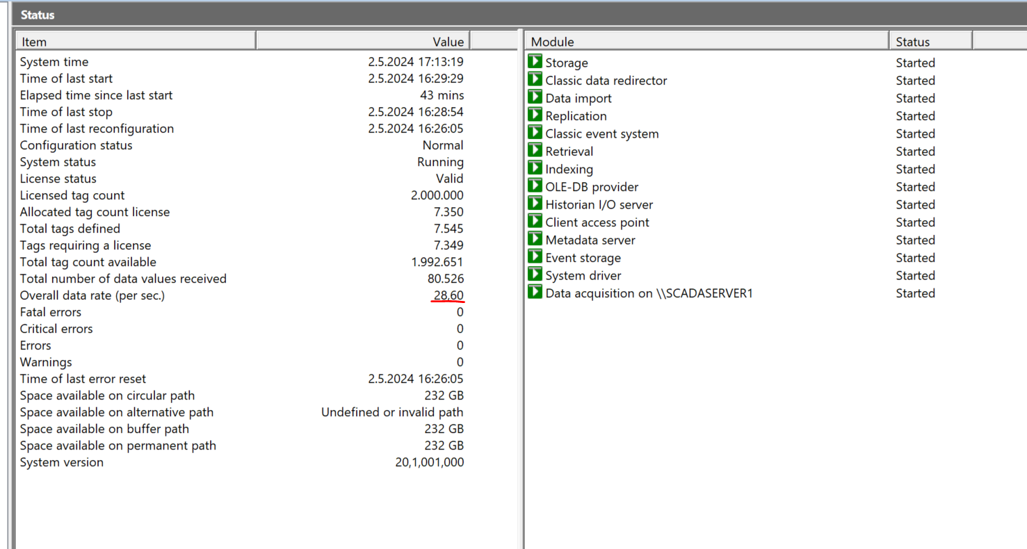

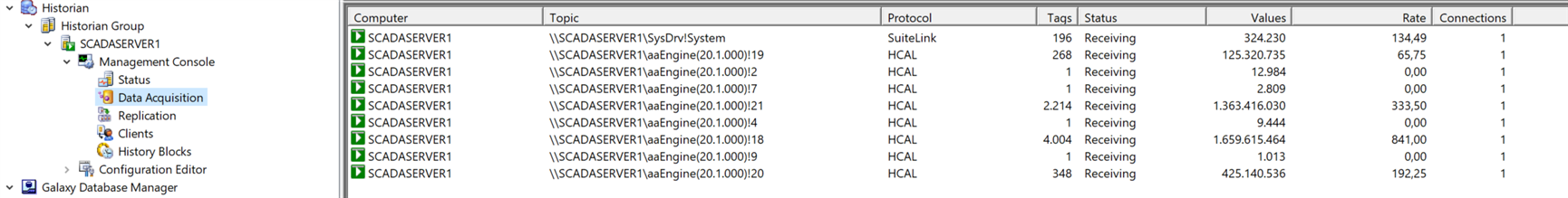

Historian not logging when re-enabling after shutdown, through SMC
Hi, I sometimes need to rename historian tags by using the rename utility from Aveva, this requires temporarely disabling the historian. This is done through the Historian Management in the  SMC. i.e. Right click Status -> shutdown and disable historian.  After enabling it again it shows a very low datarate in the status window and only logs to the buffer path.
I have solved this by restarting the windows server completely and the everything goes back to normal. The server is also running app engines and other stuff so I try to avoid that of course.
I want to get to the bottom of this and somehow get this working without restarting the windows server completely.  Is there something else i could do instead of restarting the entire machine?
System Platform 2021
Historian 2021
rgds
Jakob

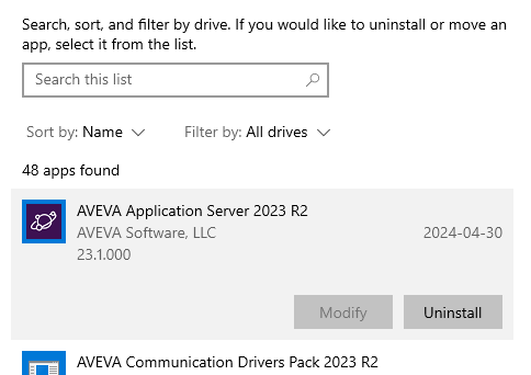

    Also verify your version in Apps and Features in windows, correct version and build should be listed here.
