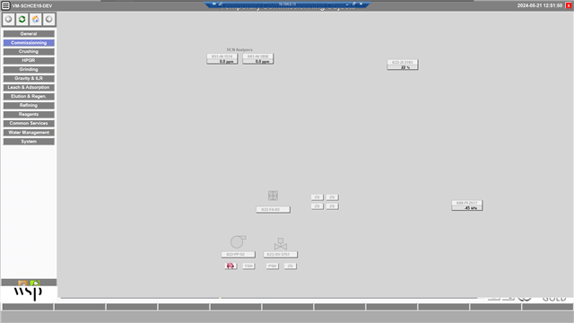

Like the question says, I want to have a bar at the complete bottom while still have the taskbar not being in "auto-hide" mode when I alt-tab out of Intouch viewer.

See how the banner is too high and overlapping the other screen?
It even goes up when I disable the auto-hide function of the windows taskbar
