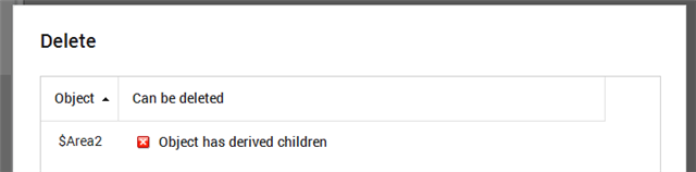

we cannot remove an Area template in a Galaxy because the system indicates it has "derived children".
However, we could not find them from the templates view and objects view.
What could we do to solve this problem?

Hi Xianghui,
You should be able to locate them via the derivation view
Hi Ido, thanks, it's a good way to find them!
