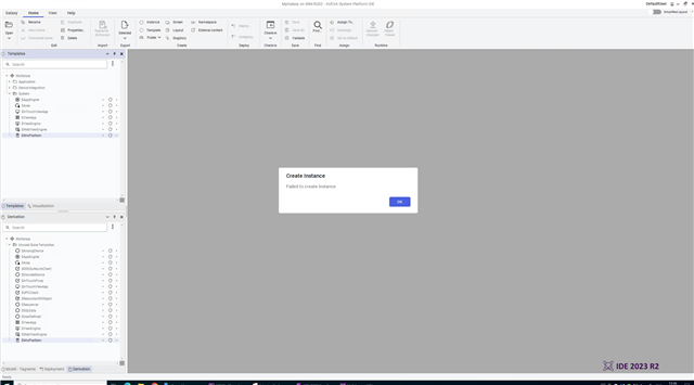

Fresh all in one node installation of SP2023R2 with a new galaxy - failing to create a winplatform instance.
I have a completely newly installed System platform 23R2 and just created a new Galaxy from the default template. What I then wanted to do first was to create a new instance of a Winplatform, which would then be on the same node as the galaxy. I get the message "Failed to create instance"  Are there any other first steps that i need to take, before i can create an instance of a winplatform?

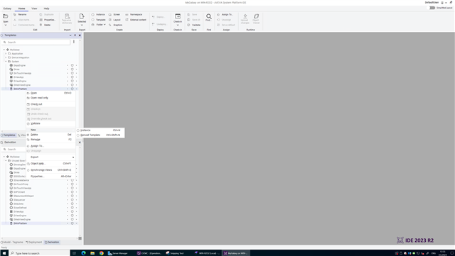

  • Hi Richard, I checked and I can create instances from other templates, area, appengines, userdefined. I can not create any new from the winplatform template, neither instance or der. template.

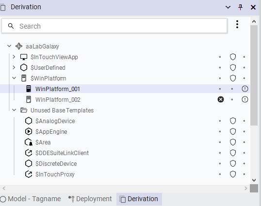

    there is already a platform as you describe.
    From the derivation view (screenshot)

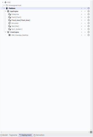

    the black platform has already some instances assigned to it
    deployment view below

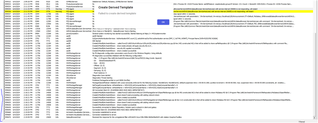

    Would it be possible to get a screenshot of the error that pops up, even if nothing is written to SMC?

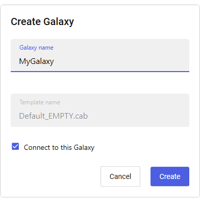

  • Hi Richard, thank you for looking into this,
    here is a screenshot, created an new galaxy like you suggested.
    1

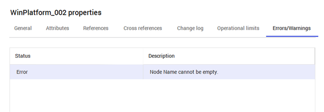

    2
    I did not get any msg in the log.
  • I tried again here is a screenshot of the log, 2:19 should be the time to look at.

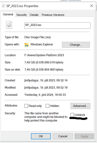

  • Hi finally solved! thank you
    the issue was this, see screenshot below
    right click on the installation file, choose unblock. then perform the installation.
