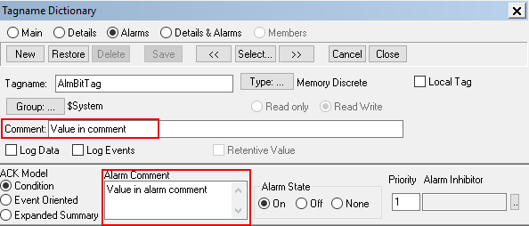

I would think this is a reserved field for legacy InTouch alarming.
This column will display the alarm comment and the tag comment data for an InTouch tag.
I don't believe it is possible to use this in Application Server alarming.

Below is the list of columns supported in Alarm Client Control and TagComment is included but I am not sure if [Attribute Name].Description is mapped to it. Anyway, it is possible to use it in an alarm query like you use AlarmComment.

Richard is right. The TagComment field is always blank if App Server is an alarm provider. It looks like we need an enhancement.
